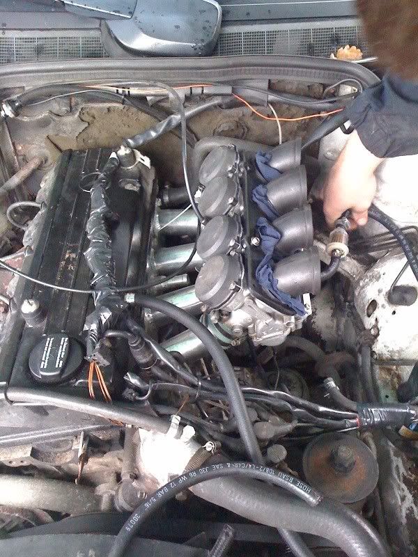

hi there has anyone done something different with induction and i dont mean the forced type.
i was thinking along the lines of bike carbs or throttle bodies maybe but not sure how i would run them? any help info or advice would be great.
Karlos28
bike carbs all the way man. i did mine in the middle of winter, in about 2 foot of snow in a weekend. drove it to my mates on friday night, did the clutch master cylinder then took all the injection crap off bolted the manifold on and slid the carbs on hooked the fuel pump up and i was done and home by 6 on sunday night and he lives an hour away.
iv not had any problems with them at all. they are so simple they just work and if anything does go wrong its very very cheap and easy to fix. i had a sticking float valve in one of the carbs, so i got some new carbs courtesy of egay for £30 posted swapped the valve and it was back running perfect again.
i have put a very slightly wilder cam in and im getting 110bhp at the wheels (130-140 ish at the flywheel compared to 109 from the factory) and im getting 30mpg compared to 25 which i got with inj.
WIN WIN if you ask me!!
karl

FYI - making an inlet manifold for a 16v engine is a huge amount of fab work due to the inlet port design. bike carbs on any petrol 4 cylinder 190/e engine would be a piece of cake - as Karlos says.....

its for an 8v 2.0 same as karlos'. Is it just a case of ripping all the old stuff out and bolting em on? will they work straight away?

as a bare minimum you'll need to increase the size of the main jets - aside from that the manifold is the hardest part. once you have them attached with the fuel connected, you're nearly there!

let bogbros make the manifold for you, they do such a good job. they make manifolds for all sorts, caterhams to 5 pot audi quattros.
