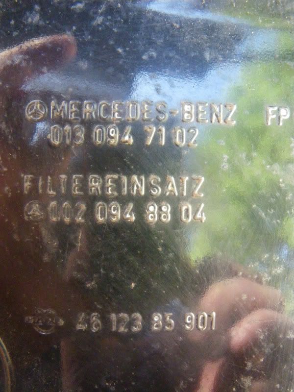

| kentronix | Tue Jun 22, 2010 6:12 pm Post #7 |
These are the numbers on my airbox lid, ![]() |

| kentronix | Wed Jun 23, 2010 9:43 am Post #9 |
I can measure mine if you like ? Although the part numbers should tell you which model its from and I can vouch that it fits under the bonnet with bonnet lining in tact. |
