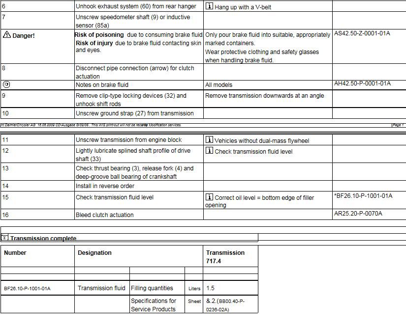

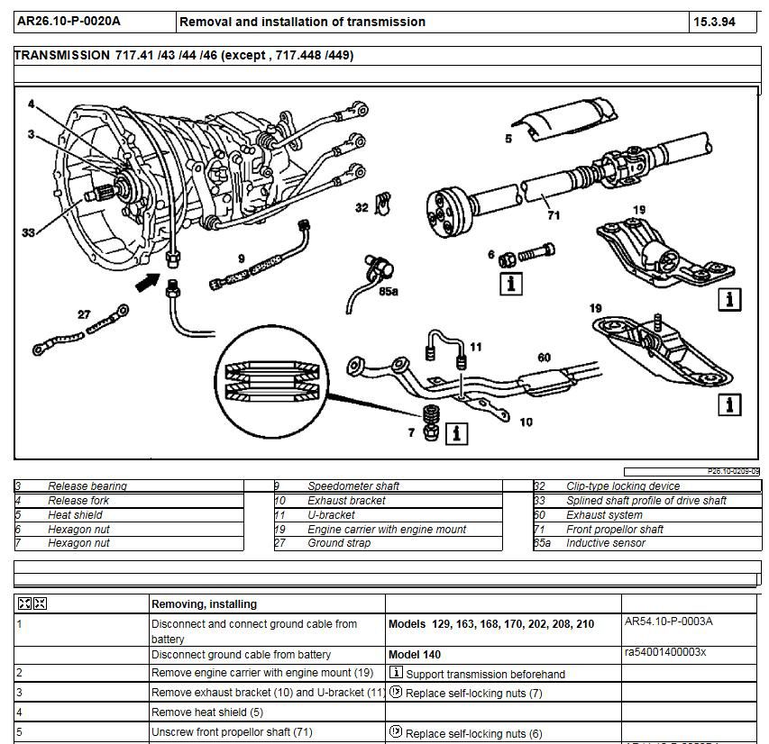

Here's a basic Wis Guide..!!![]() ![]() Cosser..!! |
