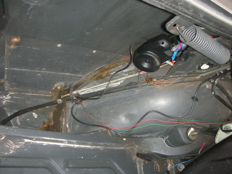

I must have a look under mine... I do know the rear jacking points are a bit rusty but seems sound. I have rust & little holes on the floor pan under the rear seat just a bit in from the jacking points on both sides but I suppose this is a common problem with them?
They tend to vary massively from rust spots to full blown inner arch seperation.

Sorry GoKart.......I'm thread hi-jacking now............... :$ but this is what I'm facing under my rear seat, not too bad I think, maybe a bit or plating needed?
Putting it off since I discovered it, out of sight out of mind!

I would wire brush that, then paint it with rust inhibitor.
Should buy you a little more time for a little outlay.

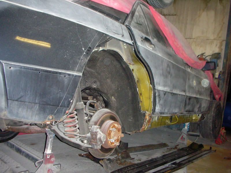

just take the kit off, it will only cost a few ££ in broken clips and youl get an understanding of what condition your bodyworks in.
majority of 16vs have rust under kit/sills/arches unless they have been garaged
looked fine..
kit off

CrysAk
Thu Jul 15, 2010 12:57 pm

Mine has also rusted at the rear wing where the bumper fixes on. This is the view from inside the boot.
I would personally take all the bodykit off and look for the rust now, rather than wait for the rust to let you know that its there. Much easier and cheaper to fix a bit surface rust than having to start welding arches on etc.

my first 16v that i totalled at the ring was 100% rust free - when i stripped it for spares I couldnt believe how clean it was - never seen one like it.
my current silver one - same year (although 30k more on the clock) was the worst one - cills, arches, jacking points - if I'd have had to pay, I reckon £1000 worth of welding....
easy way to check is to take side boot liners out. also, take the jacking point covers off and have a look through there....
fingers crossed!!

for those a little shocked at my 16, rest assured was a happy ending :P was bought as a project car so was expecting this :P

Having to fix rust is one thing....
.... having to weld and replace the lower 30 percent of the car is something else all together.

i got it done very very cheap, 2k for all rust cut out, welding + paint and flat polish finish + any returns for touch ups.
expect to pay in the region of 4-8k for a respray alone, let alone rust treatment
