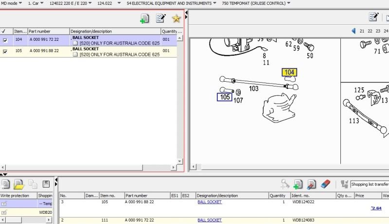

im looking for some help see if anyone can check if these numbers have either been replaced or are no longer available as they wont come up on the inchcape site then i can finally order up the last few bits for cruise control a1265400384 lever a0009917222 ball socket a1235452640 bracket the parts are for cruise control and the numbers came from a previous post thanks to papa see here cheers in advance guys |

cheers that helps a little still need help with this part number a0009917222 ball socket |
| papa | Thu Aug 12, 2010 7:18 pm Post #4 |
Apparently it's not available no more. But this one is and to me it looks the same

ended up getting one thankfully as the other end is too big for the fitting on the car so still got the problem of the missing part A0009917222 ball socket dono what i am gona do if papa is right and it is no longer available unless someone can come up with some sort of idea as to how to 'bodge it' i really want to do this right so any help would be great |

Hi everyone, does anyone have access to a Cruise Control Part for a 2.0L 4cyl? I'm happy to pay for the removal off a parts car or wrecker. Like others on here, I'm trying to retrofit my 190E (1985) with cruise control. I got all parts from a US 190E, thanks to a helpful forum member over there. But the Bracket for the Actuator doesn't fit, probably because it came from a US 2.3L. So that may answer your question dmartinezmansell. The correct Part# is apparently 1235452640, according to my local MB specialist (even though a Google search description says it is for a 2.3L). He's tried his contact at the dealership and other parts sources, but no luck. Any suggestions would be appreciated

| tom_kauf | Sat Jul 29, 2017 1:16 pm Post #10 |
Thanks for the info syncropaddy, that's a in interesting site. Unless I missed it though, I didn't see the bracket in that list (Number 32 in the diagram below).
