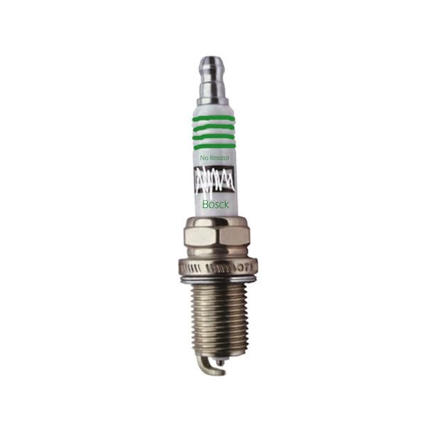

I found it nigh on impossible to get the correct plugs for my valver. I ordered the non resister plugs from ECP and got sent bloody resister ones. Took them back only to be told all of their plugs are the resister type. I found the same at GSF so ended up buying then from the dealer. They were under £2 each.
They are however champion as the dealer told me they could no longer get the Bosch non resister type, just like ECP and GSF, and not to everyone's likes. Some claim bad running when using them but i find my car runs much better with them fitted and they are still working great after over a years usage.
Ukmerctechie
Just scratch the name champion off them with a toothpick and right BOSCH on them with a fine tipped felt pen Stu ;) Add 2 green stripes around the top,for that authentic look
lmao lmao
I've got some old boxes you can put your next set in :)
Ukmerctechie
Example and please note that this is the non resistor plug ;)
Fantastic. What would i do without the great members on this site :lol: lmao
