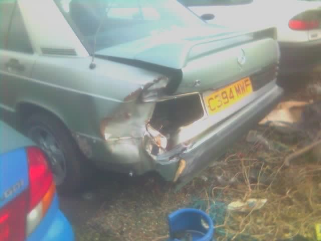

clunkyduster2
Hello all,
Thank you so much for your very kind replies!
Here are the pics of the accident - I must say I cringe every time I look at them! so I post them here now and will go into hiding straight away, out of sheer shame :'(
As I said, not looking good - though I hope something can be done! (For what it's worth, I know a very good garage in north manchester - I live in south manchester - who does really good work, though they're not mercedes specialists; they're actually honest and don't overcharge, something I wish I could say more often about garages! ^o) )
So... there it is: ( :runs away in shame: )
Uploaded with ImageShack.us
MadMike
That does not look too bad. I had similar damage not long ago ( a stone wall jumped up and ran into my car :lol: )
I payed £300, ( erm, cash money ) to have it done.Just about the only difference was that my bootlid was ok. But of course you can get one of those without much trouble and not very expensive either.
Whereare you ? I got mine done in London SW17. I can give you details if you are anywhere near.
Mike.

alan
first off dont worry that looks repairable to me if your anyway handy with the spanner head to the local scrappy and get a bumper, side pannel, boot lid and light all rather easy to remove and wont be anywhere near what the insurance company suggests but if you go for all new from merc then maybe
then take the parts to a good body shop to get the panels pushed out both side and rear and respray the other parts if your not lucky enough to get the right colour in the breakers and jobs a goodun
Good stuff, as per other comments on here that is definitely repairable by the right people.
If you can get the car out in the open and post a pic from side-on that will also help, also try to ascertain whether the main floor area of the boot has rippled.
Not bad at all that. Rear quarter will be the neatest job with a used bootlid. Rear panel looks like it'll manipulate ok and a rear lamp.
shrekky
this is soooooooooo repairable, i repaired mine and it was worse than that, cost me about £400. i let the insurance write it off and bought it back for £25, cost me about £400 to repair it, that was cutting a rear quarter panel out of a car in a scrapyard,bumper, boot lid and light cluster and a full respray, if you chose to repair it after its been written off, you will need to re-MOT it and have a VIC check (vehicle identy check costs around £30)

And dont be tempted to fit half a rear quarter, it looks awful and takes much longer - hiding the joints neatly inside the door shut and rear vent aperture is the way to go.
shrekky
Thu Dec 16, 2010 12:36 pm
although i did only replace 3/4 of the rear quarter panel( i couldnt find any full panels for sale when mine was written off ) you can get it right but i'll agree with richy it does take much longer,if i was to do it again , i would use a full panel ;)

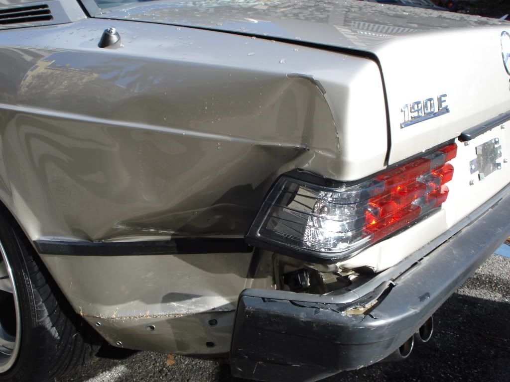

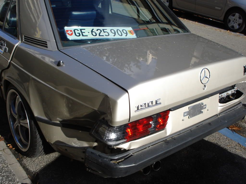

Salar
Salar Turk
Unfortunately, this was irreparable :-/
clunkyduster2
Ouch... may I ask why it was irreparable?
(cos that looks a lot like my damage.. getting nervous now!)
By the way, nice to see a 'sister' car to mine! (same country, and county of origin)
Salar's was a harder hit, plus both sides!! :'(
