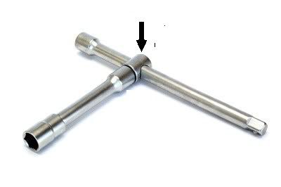

I forgot to reply earlier but I managed it. I used the bit that comes with the long extention bar of my socket set (black arrow pointing it), a multispline 15mm socket and a short, big size allen key through the hole in order to lock against the frame. The allen key or any piece of steel rod has to be thick enough to cope with 45Nm of torque. it may just be needed to hold the socket down with minor pressure untill it locks agains the frame (Be very carefull though to avoid trapping your fingers)
