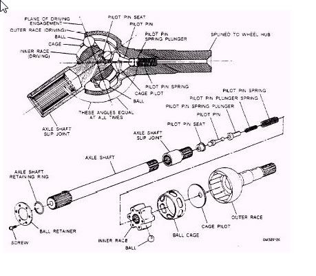

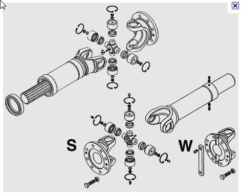

UJ's are normally found on propshafts (in the centre) or a steering column, its a + that fits between 2 halves of a shaft, the + is kept in place by pin bearings. a CV joint , is joint at the end of a shaft, with ball bearings in ,....................see diagrams A cv joint will be found at the end of any driveshaft, front or rear wheel drive ![]() UNIVERSAL JOINT (UJ) ![]() CONSTANT VELOCITY JOINT (CV JOINT) ![]() and i could stand to be corrected but i think some of the older 4x4's like mk1 landrovers did use uj's on the driveshafts Edited by shrekky, Sun Feb 20, 2011 7:35 pm.
