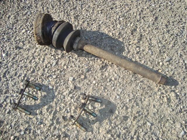

RandomTox
Here's a picture of the slight problem.
Looks like it had wanted to go for a while. Will hopefully be fixed tomorrow.

shrekky
yep thats where they always snap :rolleyes:

When the one on the other side snapped about 2 years back I was told by a mechanic that he heard the shafts have a really thin hole running through the middle of them for some reason and this may contribute to why they snap... I have no idea if there is any truth in this though.

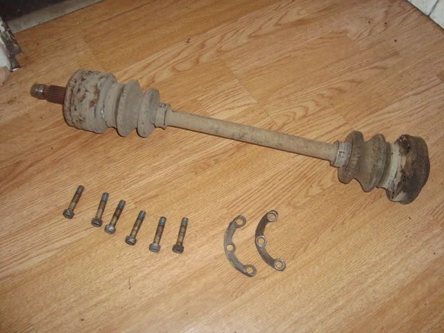

Got the problem sorted on Wednesday evening... Here's how:
After you kindly informed me that a petrol 190 uses the same shaft I called up the cheapest advertised 190 in Ireland, which thankfully was in the same county I was stuck in! It also had a fully functioning tilt and slide sunroof, which I've been looking to fix on mine for ages, and it's so badly broken that I'll need a whole new unit. So got a bus to where it was and bought it for 650 euro. Drove it back, got a local mechanic to take the shaft out, and another one to stick it in (in exchange for me washing an Integra Type R he was selling. The shaft that came out was very stiff on either end and grease level inside the boot was fairly low. I suppose these should be checked/changed regularly? Anyway, once the new shaft was in I was able to hit the road and she's driving better than ever!
So now I have 3 190s.... and one is stuck at a garage 100 miles from me!
Here's some pictures and a sort of an explanation of how it was done:

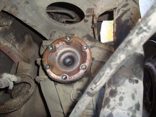

Took off the wheel and jacked it up securely. Crawled in under it a few hours before we were due to start work on it and saturated it with WD40, cleaned off the massive amount of dirt that was caking the bolts, and repeatedly oiled each one. Using an impact gun the bolts came off suprisingly easy, was dreading this bit going wrong as god knows when those bolts were last off. Was having nightmares about rounded bolt heads. Took off the diff end of the shaft, the 6 bolts and the 2 washer type pieces.
So then we could see this piece that comes out from the diff

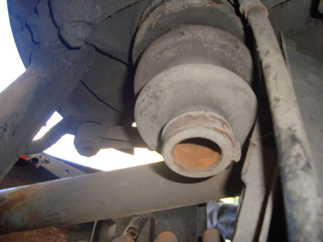

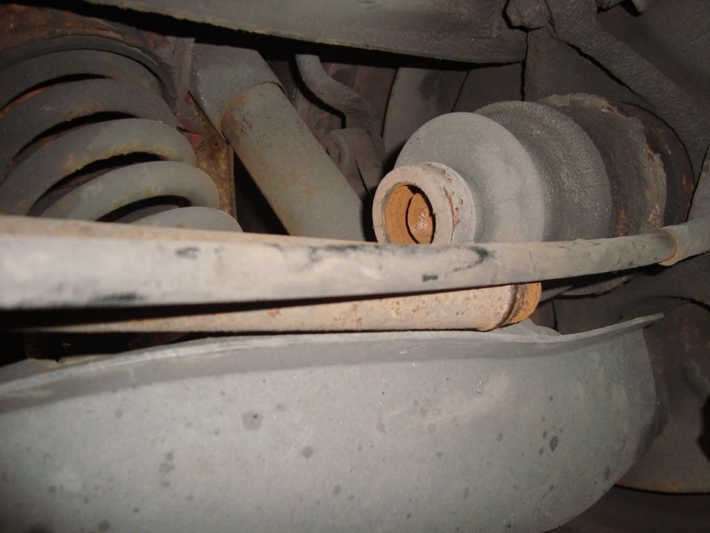

Then we had to get the other snapped piece out.
Then the nut on the outside of the wheel was loosened and we tapped this piece through. Then we stuck the new(-ish) shaft in. this is the one:
One thing to watch out for was to make sure the handbrake cable doesn't go the wrong side of the shaft as it goes in... obvious thing I'm sure but I'd say it's definitely happened more than once!
Hope this is helpful to someone, I was surprised at how easy it all is when you have the right tools. If there's anything that I missed or should include please point it out!
What's the general opinion about maintaining the shafts? Seems sensible to me that the boots need to be replaced after a decade or so of high mileage and I reckon I'll do it on the shaft I've just put in. Fairly sure the stiffness in movement played a role in causing the break, will be paying a lot more attention to this type of thing from now on anyway.
