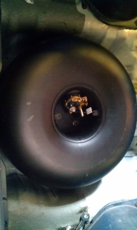

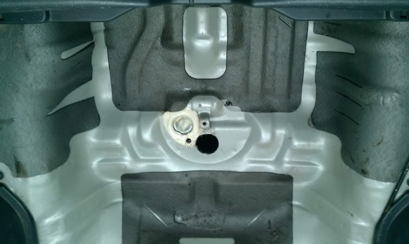

Prepped, cleaned and drilled the boot floor to mount the tank:
Applied anti-corrosive primer and stonechip to prevent from abrasions and in turn corrosion as once the tank is fitted mopping up water becomes difficult.

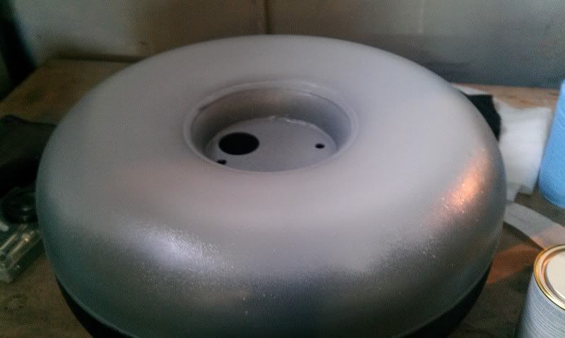

Same with the Tank:
Painted the tank and fitted the multivalve, then mounted it to the car:

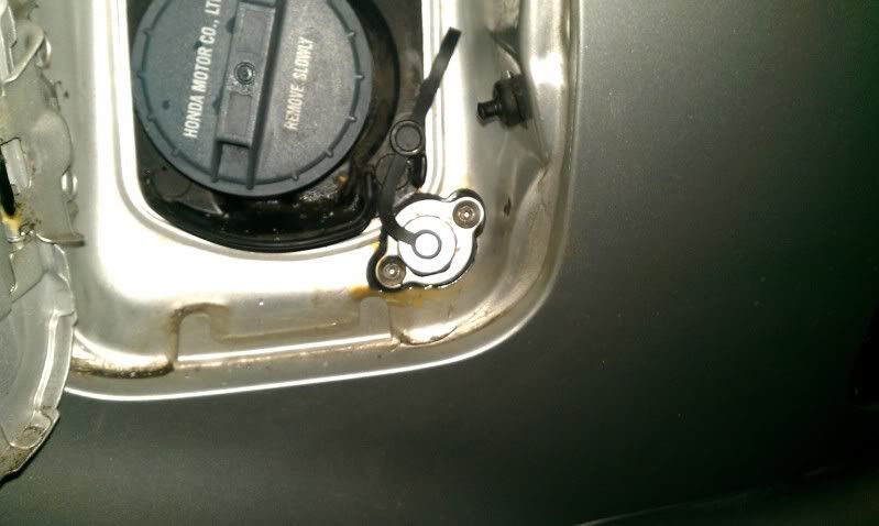

Mounted the filler inside the filler flap :)

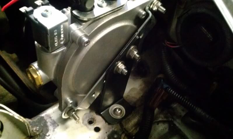

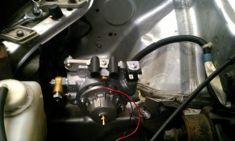

Made a bracket to hold the reducer and mounted it to the car:

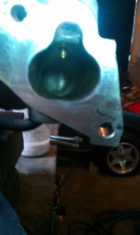

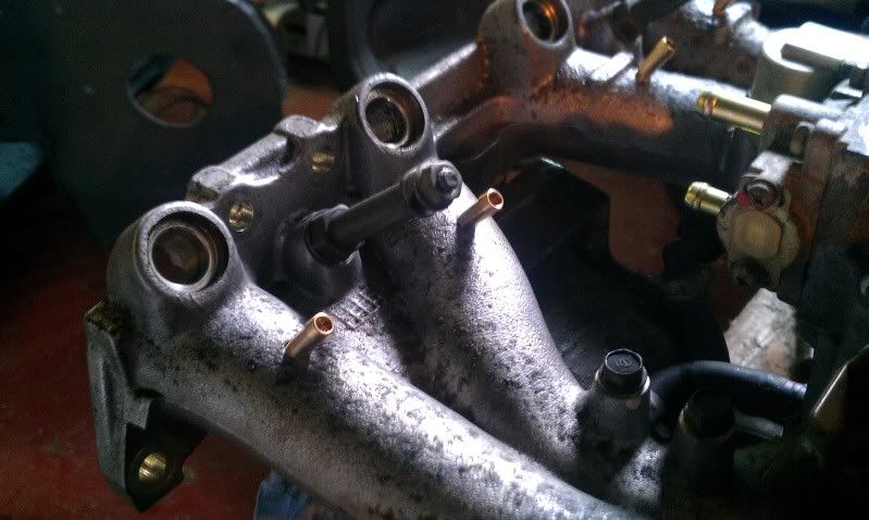

Drilled the inlet manifold for the gas nozzles:

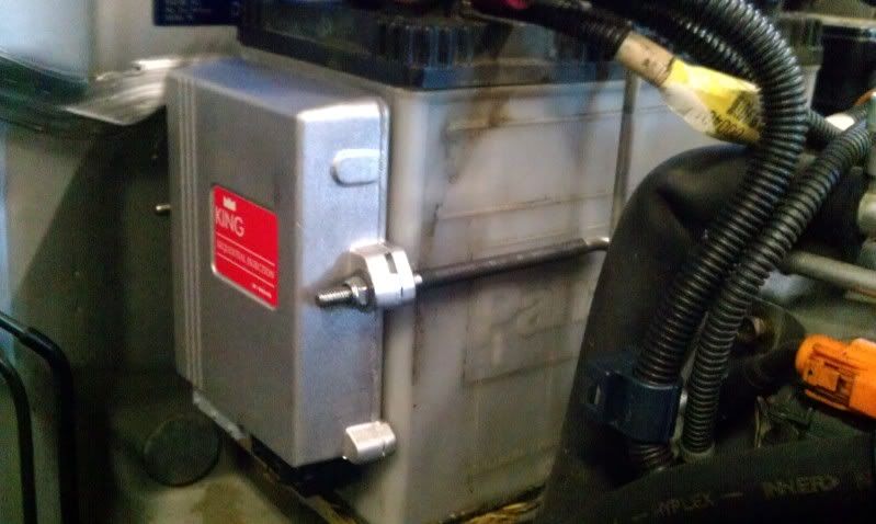

Made some 'J' Bolts and mounted the LPG ECU:

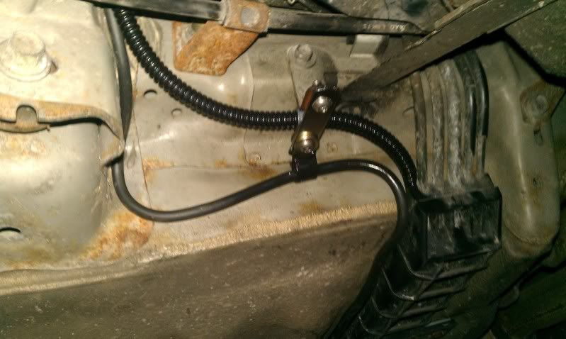

Ran the pipework and wiring harness under the car:

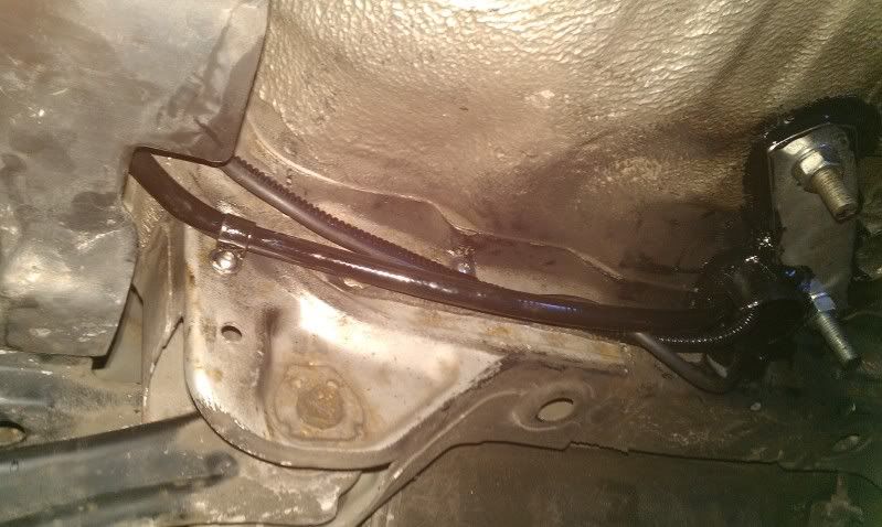

Made some brackets along the way - Posted Image
Copper pipe meets flexible tube - note foam pad above to protect the body.

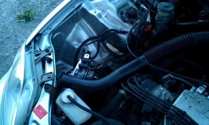

Loom and LPG hose head over the subframe into engine bay towards reducer/vaporizer:

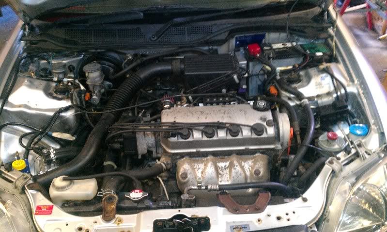

Start the rebuild:
All back together:

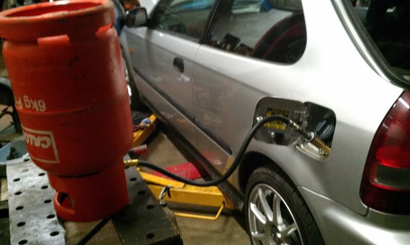

Leak check:
Relax:
So what is 6 KG's is petrol terms and how many miles will it go on said 6kg's ?
6kg is around 11-12Ltrs. I only used that to leak check the system before going 'live' on a forcourt. People get twitchy if it leaks and the nearest station was 15 miles away so handy :D
