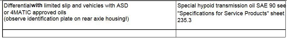

I have light on but the fluid is low, what do I need to buy ? Thanks Brett |

THis Goes In the Diff..![]() and this goes in the SLS / ASD reservoir the SLS Fluid.. MB part no..000 989 9103 10 spec sheet 343.0 sorry took a while to find the details.. its an old thread that I thought I would update with the info required....then forgot about.. Cosser..!! Edited by cosser, Mon Jan 30, 2012 5:44 pm.

Do you mean the fluid in the diff or the hydraulic fluid shared by the SLS and ASD control? |
