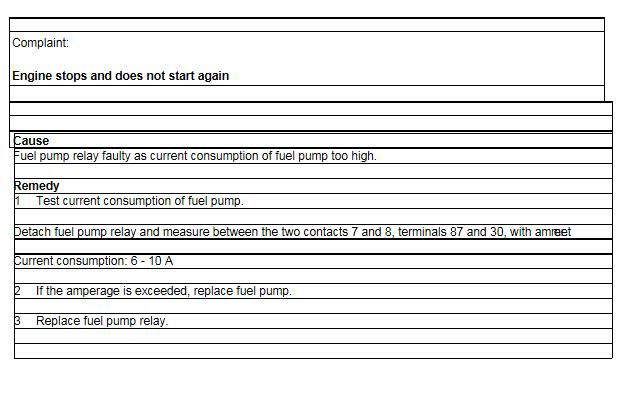

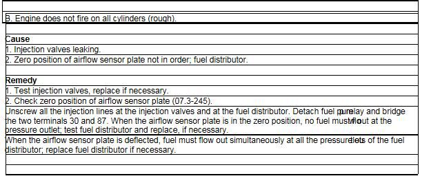

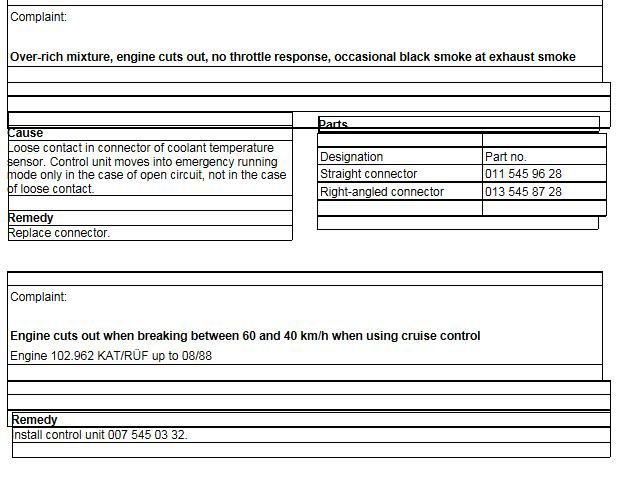

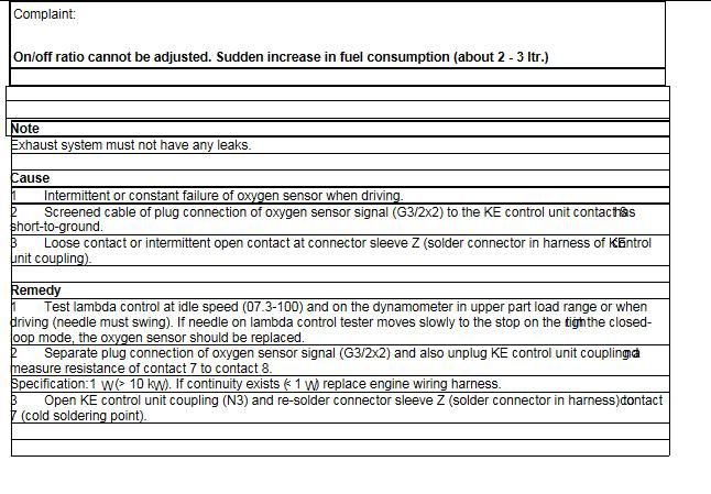

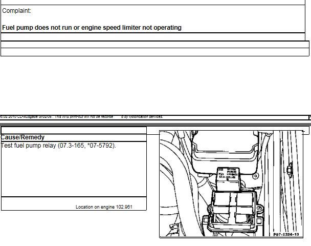

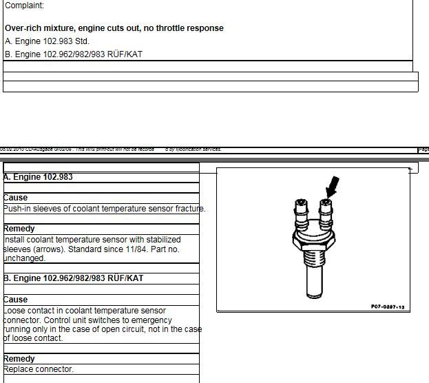

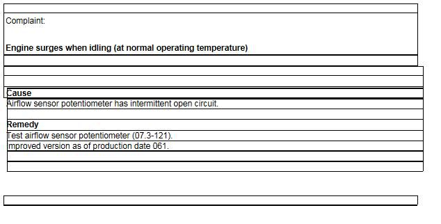

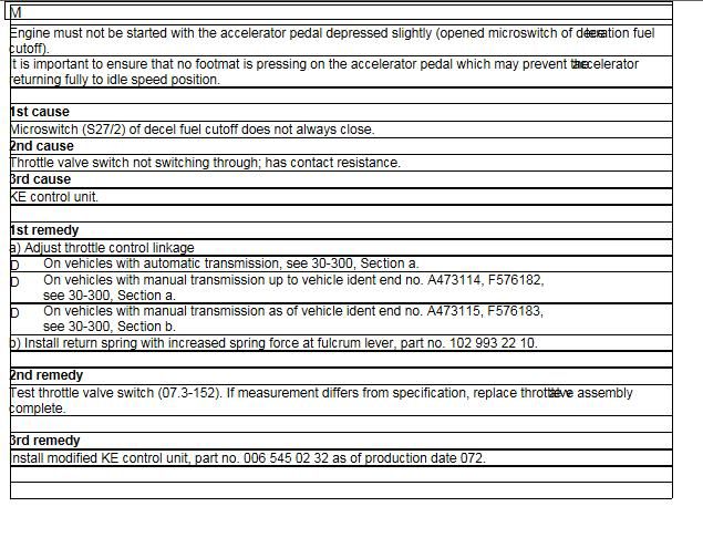

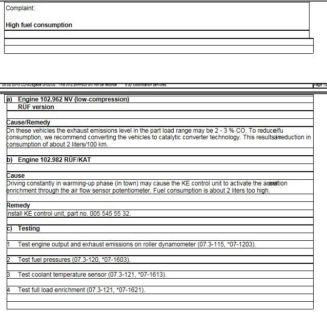

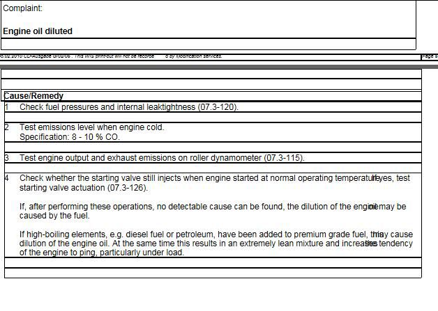

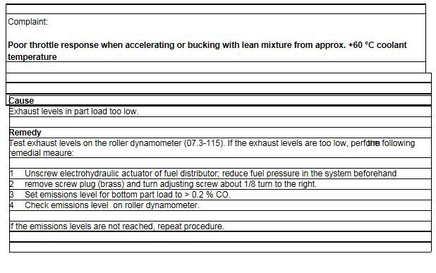

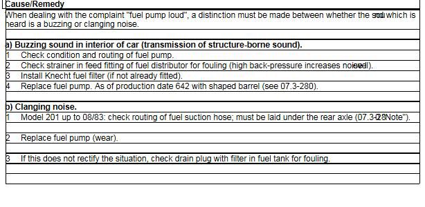

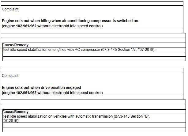

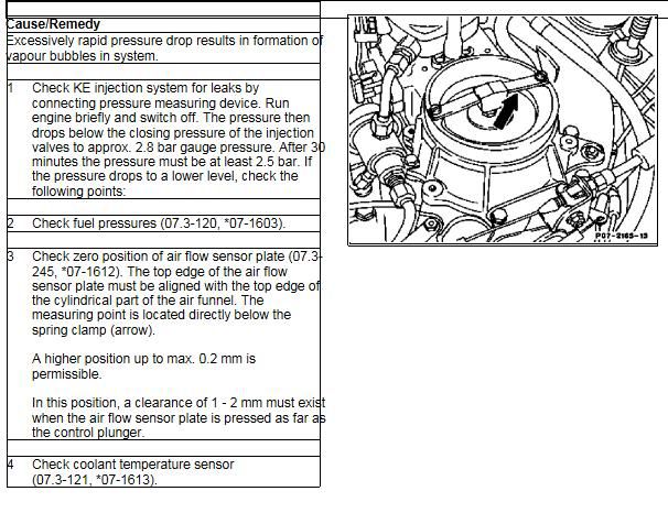

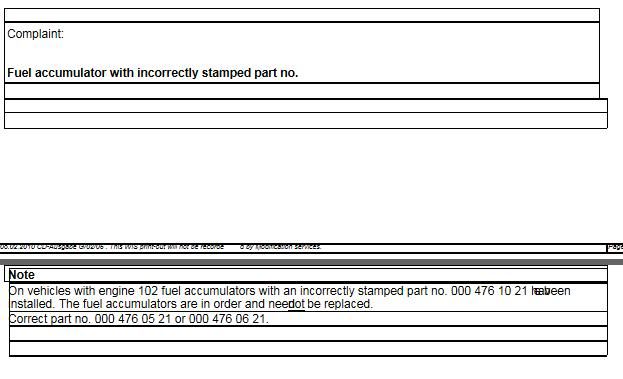

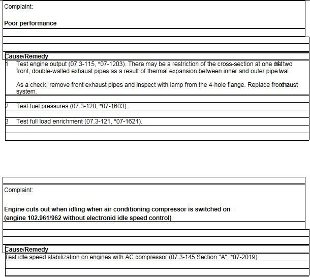

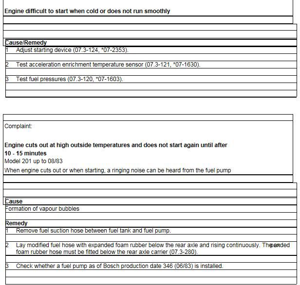

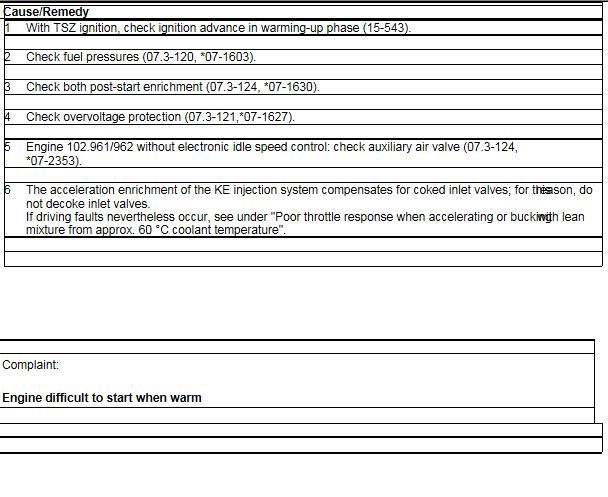

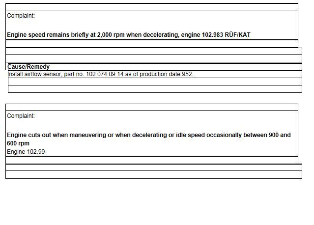

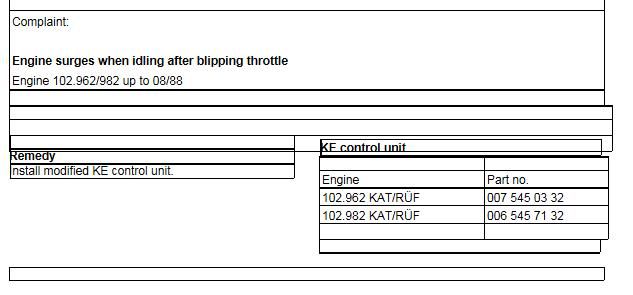

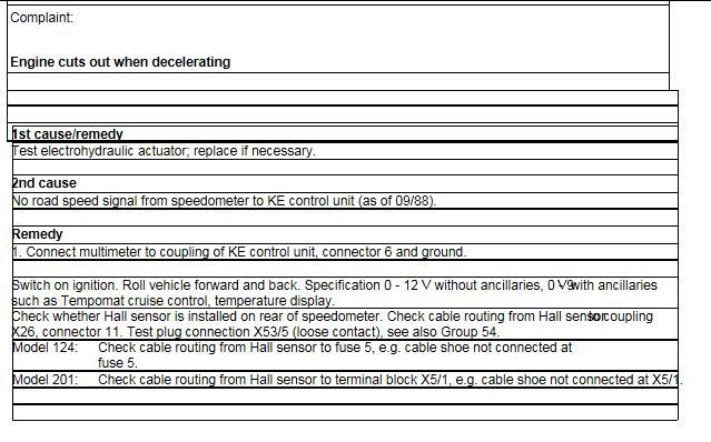

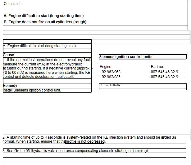

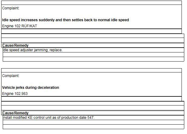

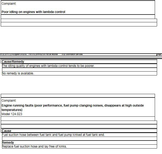

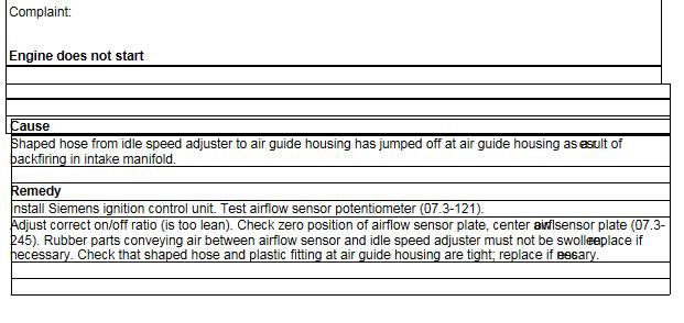

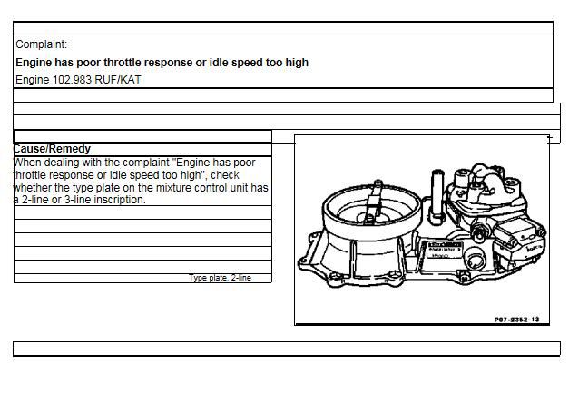

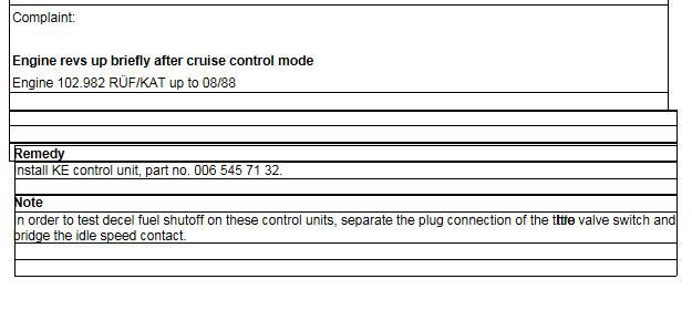

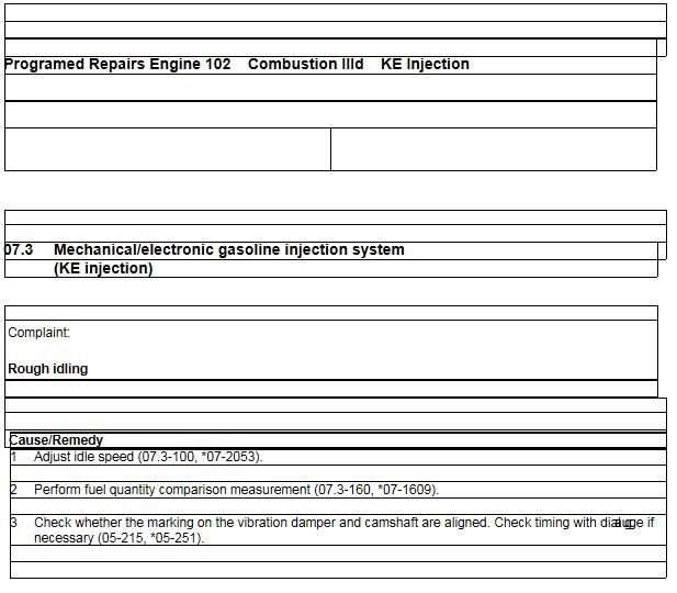

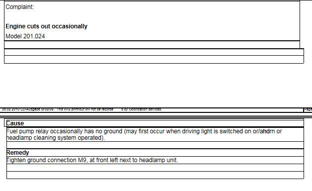

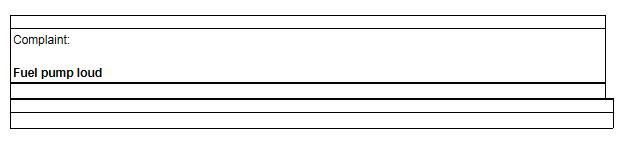

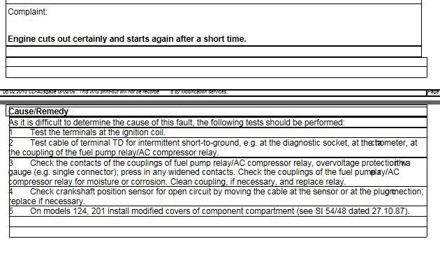

Here's a guide from the WIS manual which covers a multitude of well known headaches..I've found it very useful in the past..!!
Cosser..!!

Thank you Cosser, but I can't seem to find ScreenShot536.jpg, does it exist?
cosser
I think 536 was truncated so i re captured it..which is 537..I'll double check and if it is missing a screenshot(536) I'll insert it..!!
