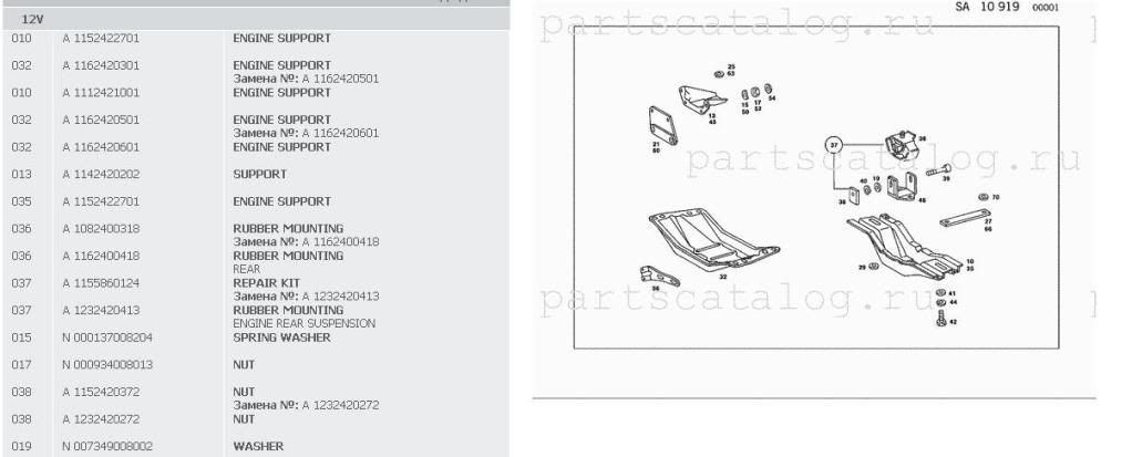

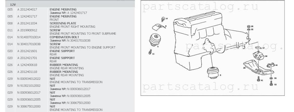

There's another section in the ECP I have which suggests the 23.16v rear mount is different from the standard models..?? This is the page on ECP with the usual known part numbers ![]() just below it is this heading.. ![]() and when you open this "Standard Microfiche".. you get this.. which seems to be specifically for 201.03 models..?? ![]() Cosser..!! Edited by cosser, Tue Mar 13, 2012 1:03 am.
