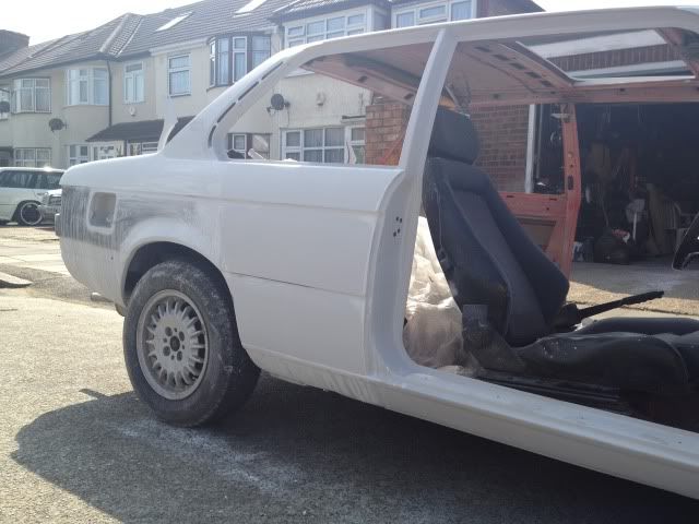

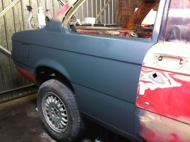

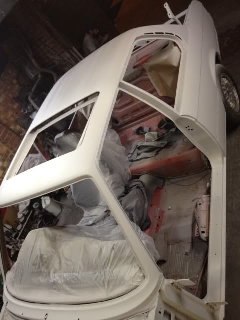

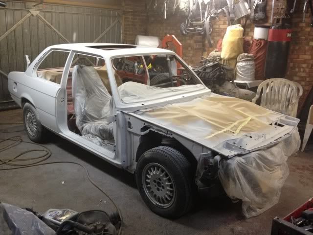

hi guys as some of you may already know I'm a mercedes fan and have always been one especially w201's, I've also been a bmw fan as some of you may recall my bmw e30 m3 cab that i use to own a while back (which i gave to my brother that sold it for peanuts!! ). I've currently got a few 190e's now that I'm working on personally but those will be a surprise when they are finished in due course hopefully, this project is a joint venture with a friend of mine, just something to do on the side on weekends or when when bored, the car came with a 323i engine that was knackered, we've managed to find a 325i motor sport m20 engine from the later e30 mtec sport, and swapped it along with all the wiring and management system. we patched up all the rust holes (welded) on the floor and around the sills, and started getting the panels straight and stripped the whole car, eventually after a few weeks "lol" long i know... we managed to get the whole car in primer and almost finished blocking it down ready for paint, of course when its painted ill be hiring out a booth local to me at one of my friends garage...hope this isn't an inconvenience sharing a non mercedes w201 on this forum, and since its the only forum I'm currently part of thought ill do a little post on it and see what you guys think of it... rear quarter bear metalled and panels beaten, lightly fillered and primed ![]() masked up ready for final primer ![]() primed ![]() ![]() slapped on some guide coat powder and start blocking the panels ![]() hope you guys like what I've done so far, as the project goes along and eventually gets finished ill keep you guys posted |

Nice one mate top work! |
| Neil | Sat Mar 31, 2012 10:44 pm Post #3 |
Really like these. Looking forward to updates
| spic | Sat Mar 31, 2012 10:46 pm Post #4 |
Love the e21

was thinking about changing the colour maybe to BMW GRAPHITE 087 1981 1982... |
| Daliscar | Sun Apr 1, 2012 12:40 am Post #6 |
Always On The Ball
Fantastic work, just love to see restoration jobs, particularly harder at home as a D.I.Y. Great stuff !! (even if it is a B.M.W. )
| Neil | Sun Apr 1, 2012 12:59 am Post #7 |
Metallic Grey looks lovely on the older, pointier cars - do it!

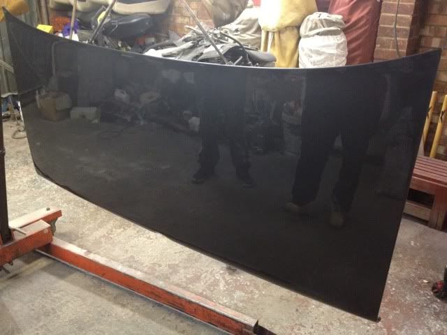

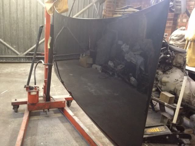

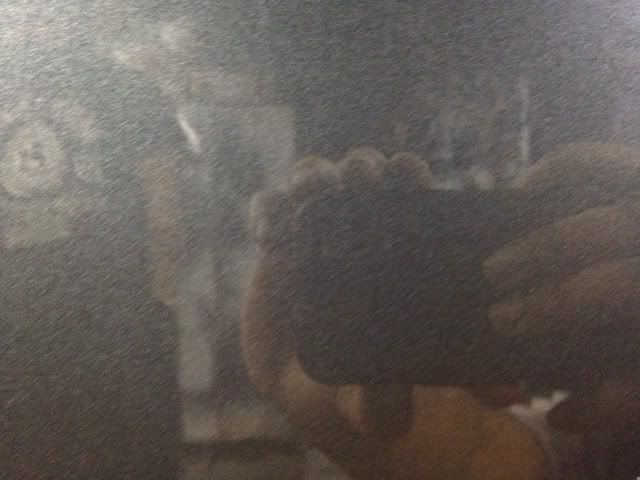

i couldn't wait to try out the new colour, i really wanted to see how it would come out... so, thought id give it try on the boot lid, figured if i make any mistake or i don't like the colour i wasn't going to paint the whole to find out... heres some pictures i took... ![]() ![]() ![]() the spray gun i used is Deltalyo Sigma 6000, has any one used this before? what do you think? the lacquer i used is HB body auto clear, ice used it before i kind of like... apparently this is what TVR used |

Never used a Deltalyo before (DeVilbiss and Sata being my weapons of choice) but looks like it has laid down a good finish though
