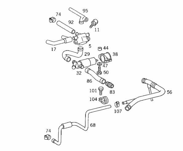

Hi, Recently had starting problems from cold, I have to turn over 4 5 times with foot slightly on the pedal till warm then fine. checked ovp fuse, fuel pump primes etc.. been reading about the cold start valve and vacuum pipes so before I find time to check them out I would appreciate if anyone could point me in the right direction of the vacuum pipes which could mess about the starting system, car is a 1986 2.3 16v thanks in advance |

what is the first 9 digits of your VIN number (e.g mine is WDB201024 for the 2.0 190e) - then I can upload diagrams for all the vacuum idle pipes

cheers mate its WDB201034 |
| griffin | Tue Jun 5, 2012 9:32 pm Post #4 |
There seems to be 2 diagrams for the idle vacuum - not sure how they relate - note one of the diagrams has greyed out numbers - meaning those parts aren't applicable (apparently). Hope these help...![]()

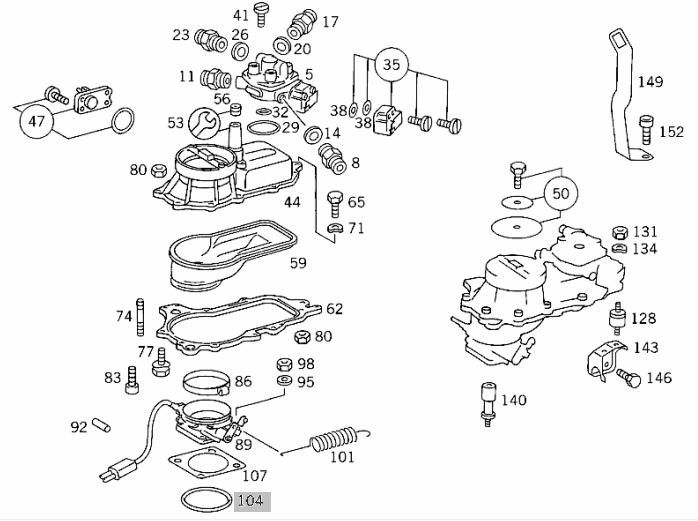

and here is the air flow meter - part 59 is rubber and can crack causing issues in the same ways as split/cracked vacuum pipes. You can also have starting problems if the thin vacuum pipe that runs from the ignition to a vacuum pipe under the air flow meter gets knocked out of its rubber connector pipe (at least this is the case on the 2.0 190e)

super job that should keep me out of the wife's way at the weekend...thanks |
