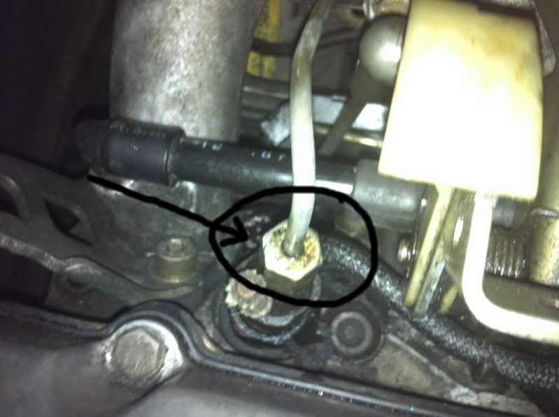

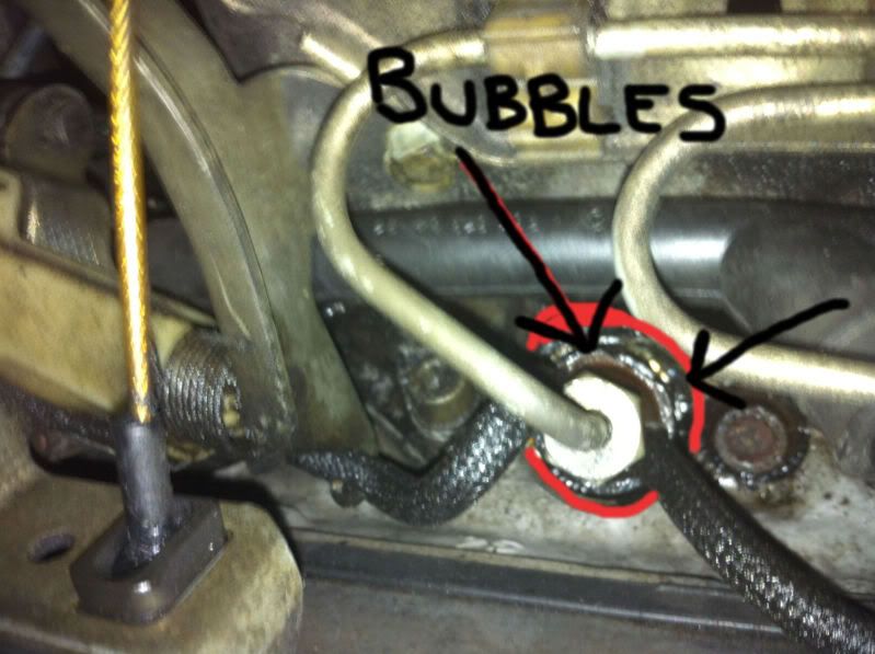

So here are the issues.... First picture shows where the diesel is leaking from. Apparently it was gushing out and a local garage put some rope to try and help the seal. It is definitely seeping still as you can just see in the photo. ![]() This second picture is more difficult to see, but the video shows a glimpse of the problem. At the bottom of the injector, where it goes into the head there is bubbling. I assume it must be oil that is bubbling as air is leaking from the thread. Can this be solved by tightening the injector? ![]() The vid may help, its a bit short - but hopefully shows the leak on the injector nearest the bulkhead and the air bubbling on the 2nd injector. Lastly, every now and then there is a loudish 'clack' sound I'll leave this for now but could it be related to an air leak? Any help gratefully received... |
| kentronix | Sat Jul 7, 2012 2:59 pm Post #9 |
I would remove both injectors, completely clean the hole, the injector (including threads), and the end of the pipe. Do it all back up firmly and see what occurs. Careful not to let too much crud fall into the injector hole, I would clean the outside of the injector (where it goes into the head) as much as possible before removing it, get rid of anything that may fall in. |
| franey | Sat Jul 7, 2012 4:39 pm Post #10 |
The prechamber needs to be tightened, requires a special socket! Just tightening the injector will do nothing, you need to remove injector then tighten prechamber then refit injector. Looks like you also need to replace some of the leak off pipe. In which part of the country does one reside? |

Found the likely cause, a small fracture in the injector pipe, just on the shoulder. Im looking for a replacement pipe - if anyone has or. I've also posted in the wanted section. Cheers guys |
