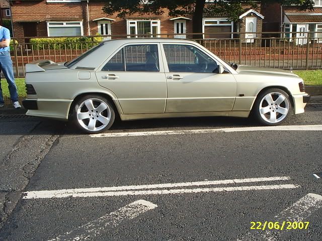

Hi Guys, Cheers for the info much appreciated. Have you got any pics of a 40mm drop on the front? Cheers Ash |
| shrekky | Mon Mar 10, 2014 5:29 pm Post #5 |
mine has a 40mm drop all round mind my car is in 17 inch rims ![]() Edited by shrekky, Mon Mar 10, 2014 5:33 pm.
