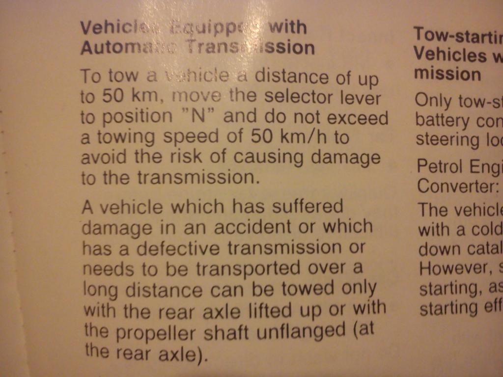

Thanks for your responses folks. I won't need to run the engine and can't as there is no water pump. I thought the gearbox pump was on the prop side of the gearbox (hence the ability to bump start with an auto box) in which case it should pump the oil out and cause possible damage. Thanks guys this has confirmed that a shall have to remove the prop to tow. |

| stwat | Sun Jun 8, 2014 10:36 pm Post #9 |
It can be towed no problem. This is from the owners manual.
8:24 PM Jul 11
