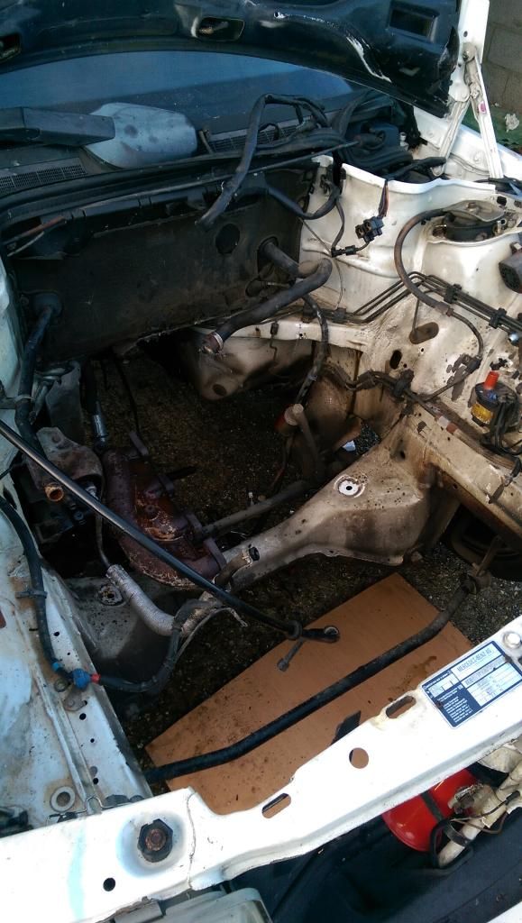

| jason3249 | Fri Jan 30, 2015 7:03 pm Post #22 |
well people didnt take to long to get it out going smooth so far the new engine is going in tomorrow hope it goes smooth agen lol![]()
