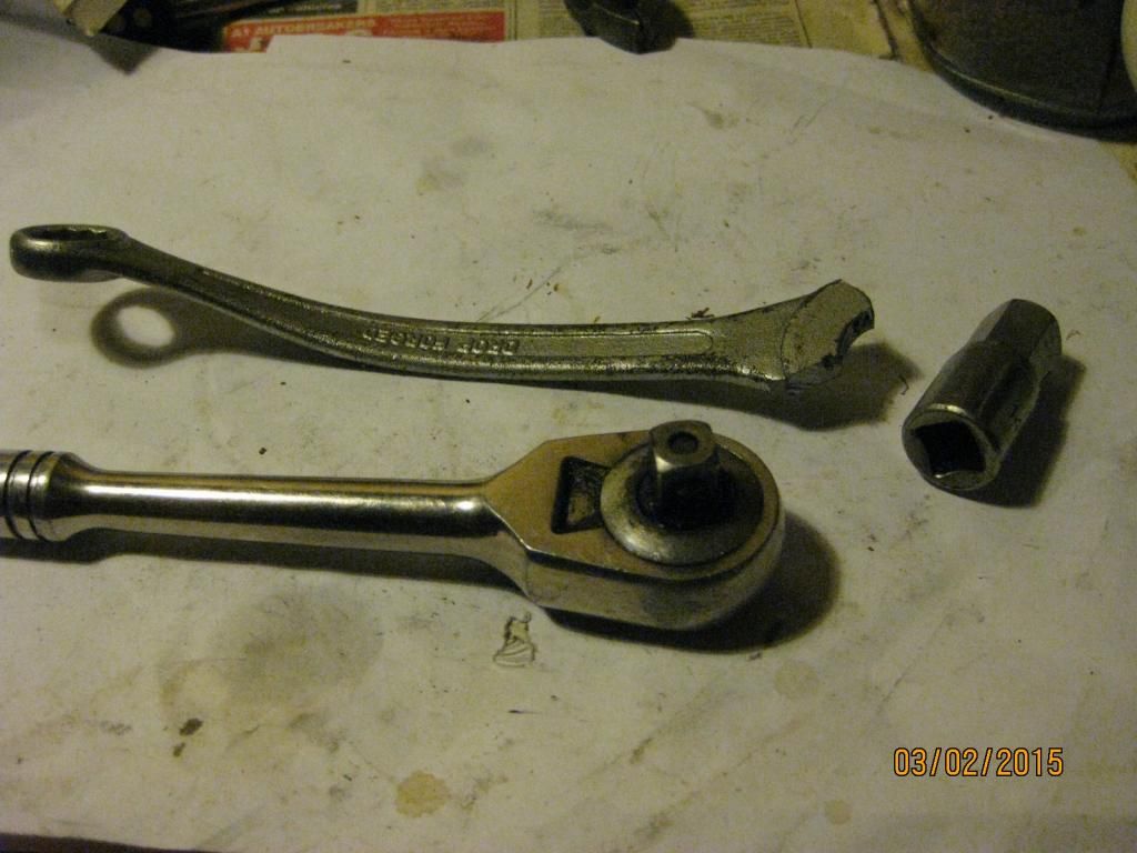

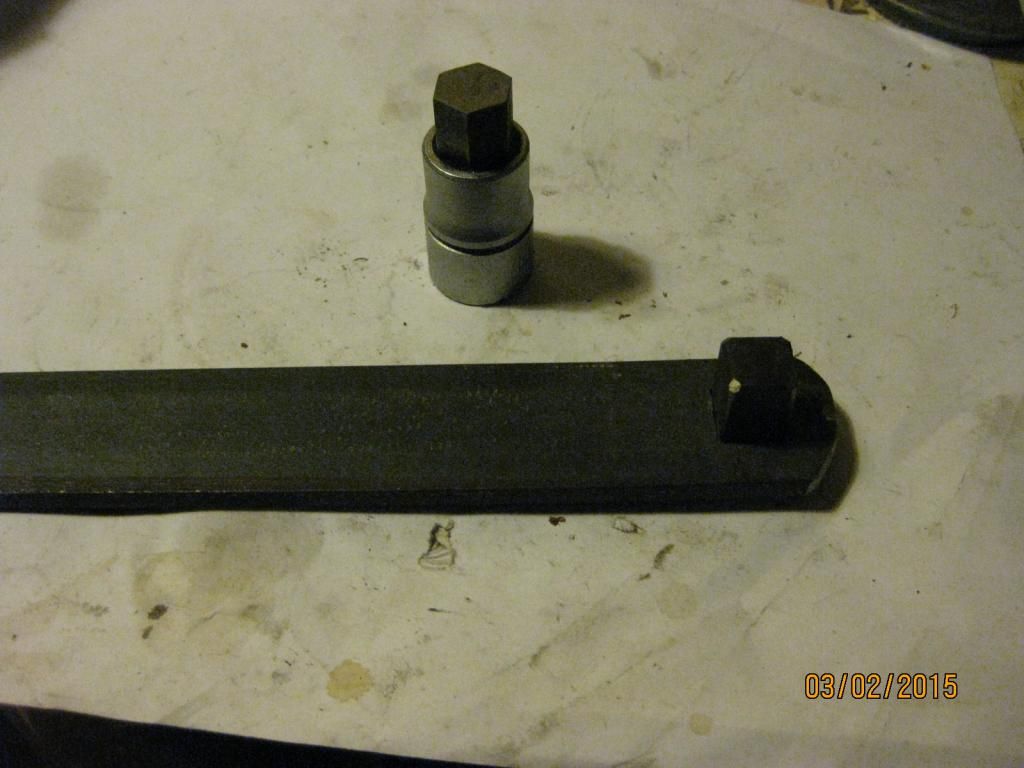

Try again The bits I broke (3/8" drive) ![]() The bits I made - 5 x 30 x 500mm strip and 1/2" square bar through 1/2" hole filed square and welded ( welder don't like high carbon steel) ![]() ![]() Thanks for all the suggestions, all good stuff but I needed to do it lying on my back outside... Cheers, Pete |
