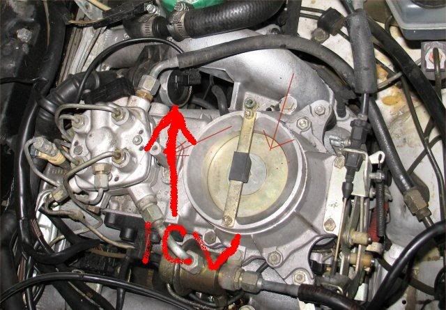

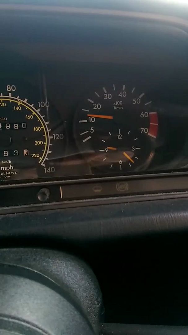

well people didn't think it would be so smooth lol the engine is idoling funny keeps going up and down and think its running abit high cant adjust the throttle as the linkages or maxed out and sitting on the switch if i start it and dont touch the accelerator it dont rev up and down only starts to do it if i rev it what you think it can be just fitted a 2L in a 1.8 190e the old 1.8 engine didn't do it did have to change the temp sensor over as the 2L one didnt fit the 1.8 loom one day it will run problem free lol heres a video of it iv all ready reved it so its doing it ![]() got this picture of the net iv got a spare connector on my 1.8 loom I think it plugged in to the icv but cant find it on the 2L engine is it meant to have one as the old 1.8 engine did... ![]()

| Gaz2N | Tue Feb 3, 2015 9:22 pm Post #2 |
Old Merc nutter
Sounds like you may have two different versions of KE maybe? Do you know if the 2.0 was out of a car which was much older/newer? I would suggest that you look on the Mercedes Benz Club technical archives as there is a lot of info there about tests to be carried out on KE. You'll need to be very methodical. Good luck. Gary |

whats a KE can i just fit the icv to the 2L engine take it of the 1.8 or was thinking about taking the whole fuel system of the 1.8 and fitting it to the 2L would that work don't know the age of the engine all i know is its from a 190E that picture is from the net just to let you know new problems new theads sorry about Edited by jason3249, Tue Feb 3, 2015 10:03 pm.

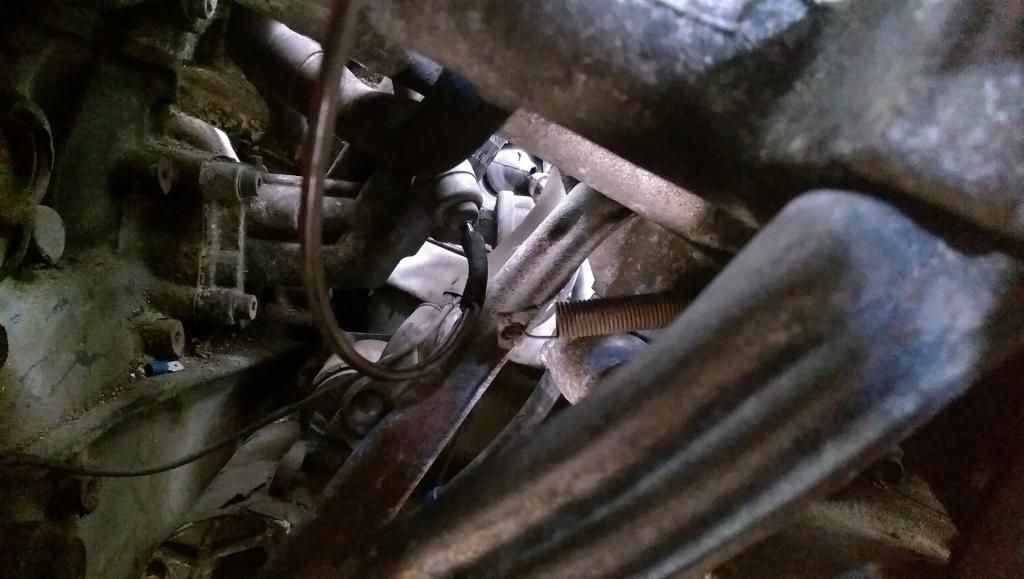

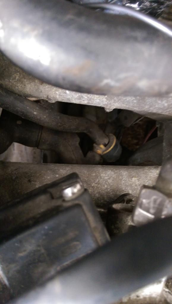

iv got it to idoling fine now what i done is plugged a vacuum in the rong place took it of and it idols fine now but dont know where the right place for it is..... if i suck the vacuum pipe it revs high then starts to rev up and down agen ![]() heres where the other end goes ![]()

if i suck the vacuum pipe iv took of the engine it starts to ruvs up and stays high then starts to rev up and down but think its starting to rev up and down agen so back to to same problem when i took that vacuum pipe of it stopped but now it does it every now and then thats why i through it stopped if i put that vacuum pipe back on it does it all the time like in the video thanks greek taxi all my vacuum are the same as yours in your pics the vacuum what i cant find its place for is coming from the big rubber boot under the injection system where you plug that pipe in under the big rubber boot and then it goes up to the icv I think its a icv its at the back of the engine next to the water pipe for the matrix thats where the spare vacuum pipe is coming from well the vacuum pipe goes on a thin pipe then joins up to the icv

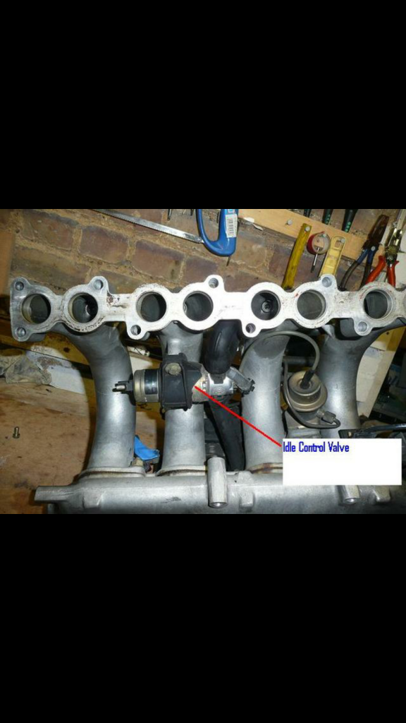

got this picture of the net ![]() my 1.8 old engine had whats in the picture icv but dont have a vacuum line on the new 2.0L engine i didnt have a icv in picture well i don't think i do or did i think i found it at the back of the engine so what i mean the icv connects to a pipe then connects to the rubber boot under the injection system well that pipe what connects to the boot has a vacuum line coming out of it and dont know where it goes from there... Edited by jason3249, Wed Feb 4, 2015 8:05 pm.

| Greek Taxi | Wed Feb 4, 2015 8:45 pm Post #19 |
Jason, your post at 9.47am, picture 2, I don't have that valve on my engine (1.8 manual). And I can't see anything similar elsewhere under the inlet pipes. |
