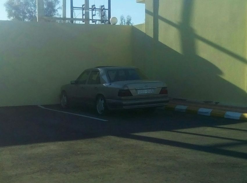

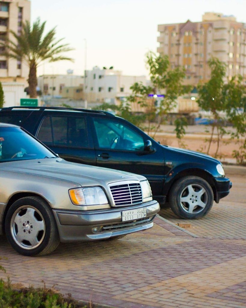

hello Every one.
after more than a Year Since I Sold My ML320 , I Drove around in my Dad's S124 that's Just Giving up on all Levels.
a Colleague of Mine Had this Beautiful W124 E300 1990 with 17" AMG Wheels , front and Rear AMG Bumpers. I thought he Sold Since he was Driving a Jeep.
he then Told me that the Merc. Is Up for sale. and what I did was that I Grabbed It.
in the Time He Drove the Jeep , his Brother Used the Merc. and it didn't See it's Best Days with him .
there is a ton of Work to be Done for Her to Be in her Prime.but She Has Potential.
here is She, as bought.

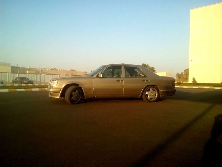

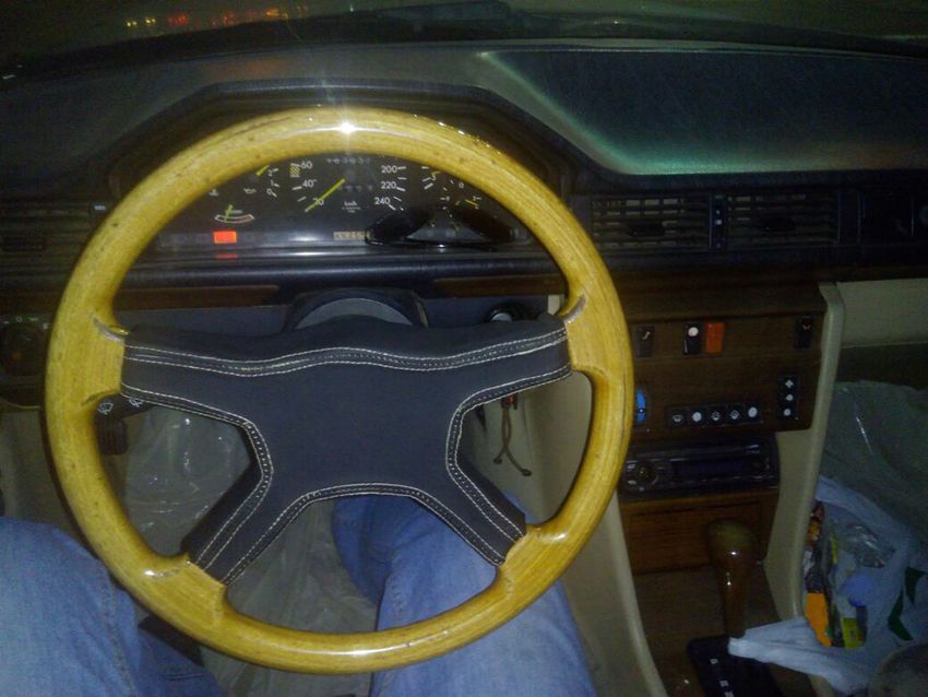

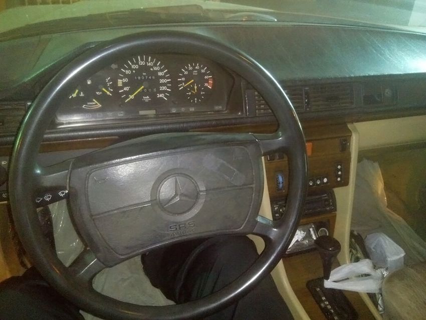

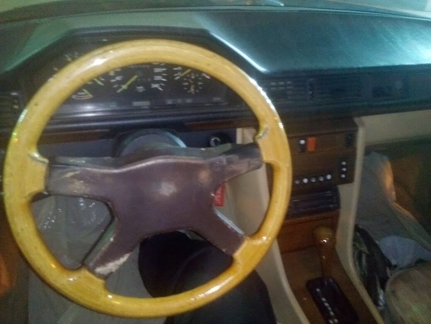

changed the Huge Steering wheel and Old gear knob
here is before,
after:
and Now,not a very pretty work was Done.I will have to Find another Shop to Do It Properly.

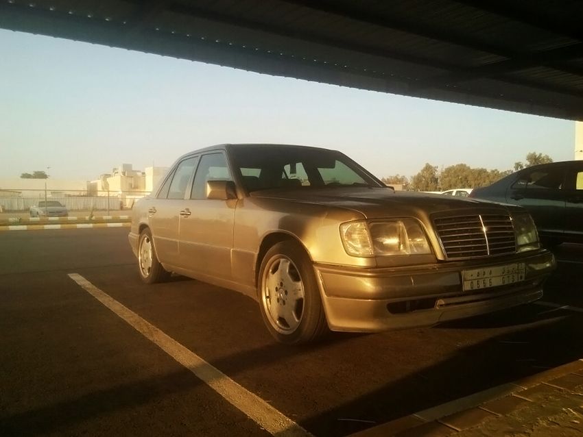

the ride height is a mess. How Much does the H&R Set Cost? any One Has Used Set for sale?

Ride height is a mess
I think it's ok for a standard non Sportline.

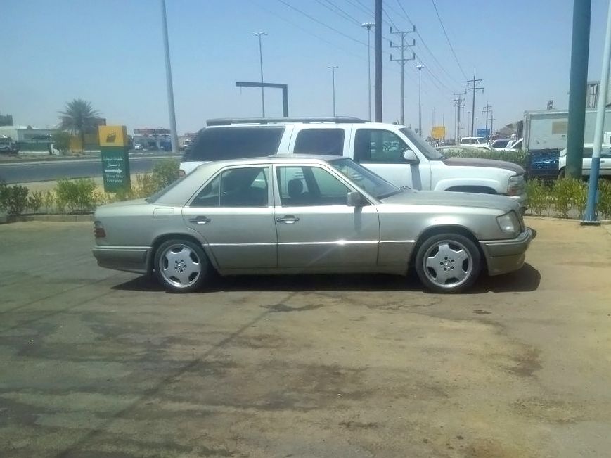

After I changed the Tires I noticed a very Harsh Vibration at 100 Km/h.
went to check that Out. only to Find that I had Both Right Side Rims Bent & the Front one seemed it Suffered the Worst hit of Both.
I Checked all 5 Rims.and Turned Out 3 out of 5 are Bent in a way or another.
took the Car to a Specialized Shop that Promised he Can Fix them.3 Hours of Machining Later, they came out and they Seem to be OK!! although I Don't Trust them any more. they are Original AMG Rims Not Some Chinese or other knockoffs but Still !!
so , I plan on Changing them at the Soonest Possible Chance.
but after all, I am Enjoying Fixing this Car So far. and I hope all this Effort work Out Well.
