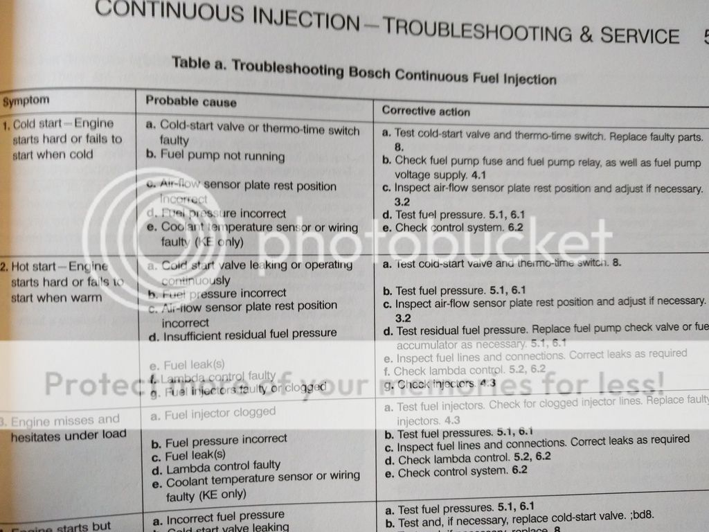

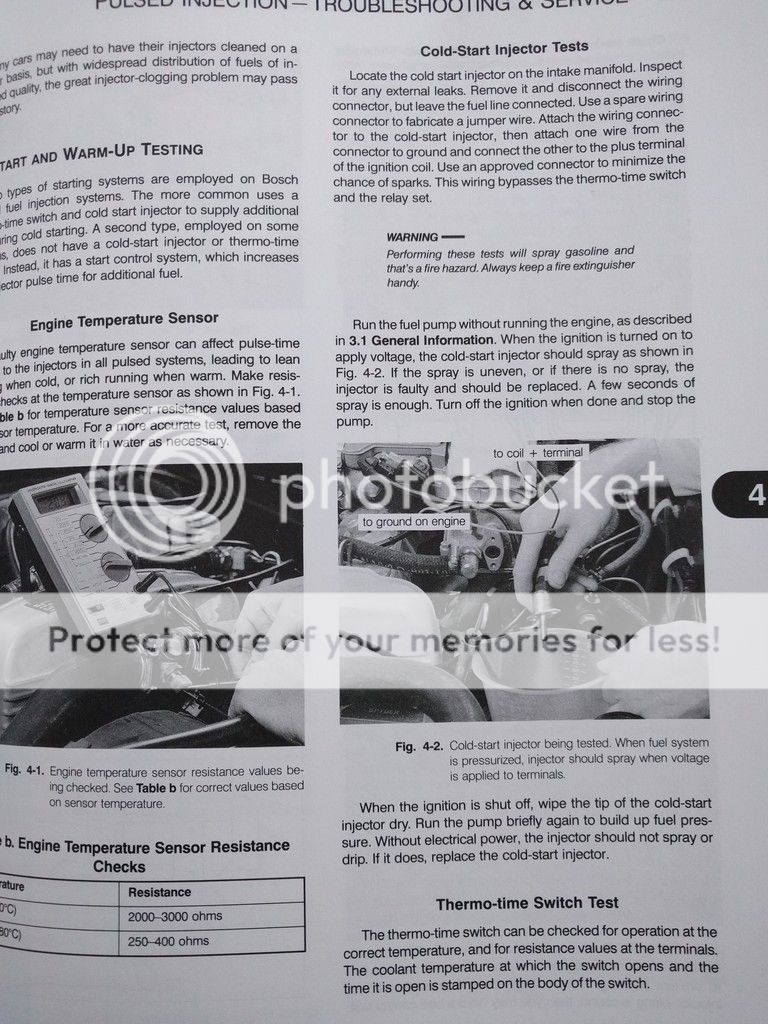

Here's some material that might help you work things out...
From what I can glean from the book I got this from, one side of the cold start valve is LIVE from the ignition (when the key is in start position only) - the other side (link to EARTH) is made by the engine control unit - only until the engine is up and running. A cheap multimeter will tell you if the continuity to earth is provided by the ECU at cold starting time. If it is then the valve is faulty - otherwise you it is the ECU / other electrical item that needs investigating - which may be solved by relay that you've ordered.
A cheap multimeter is the way forward...
And I don't think your car will have a thermo-time switch - its role is replaced by the ECU
First item in table is for cold start problems
Right hand section is for testing cold start valve (same for pulsed and continuous systems)
Edited by griffin, Tue Oct 11, 2016 6:14 pm.

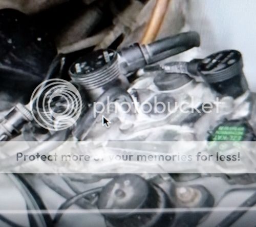

just looked at your video - sounds like its misfiring and the revs going up and down seem like idle control valve - or vacuum leak problem.
I have also noticed in the video that the ignition control unit looks like it has a rubber vacuum connector with a missing vacuum tube.
That could be responsible for the vacuum leak and ignition problems - may be - if it is missing which is difficult to see...
This is your car - the rubber connector with missing vacuum line is where the mouse pointer is - I think - unless it is something else and I'm mistaken
Equivalent on my car
Edited by griffin, Tue Oct 11, 2016 7:39 pm.

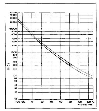

  • the resistance of the temp sensor - it showed 1.1 K ohms - what was the temperature of the car at that time? - if it was cold this isn't right - see the graph below
  • at cold (say 5 degrees celsius) - the temp sensor should be something like 4.5K to 6K ohms
  • your video showed zero volts going to the csv when you started the car - but the car started ok - was the engine warm? - the csv only gets voltage at coolant temperatures below 60 degrees celsius - i.e. with coolant sensor resistance of 600 ohms or above
  • if your temperature sensor is defective you could try putting a 6K ohm resistors across the plug (diagonally across the connector - see image below) and seeing if you get a csv voltage/current at start-up
  • the bad rubber breather hose is probably responsible for all the oil that you noticed on the side of the engine on the intake side
  • if the coolant temp sensor seems OK (after checking the above), and you've replaced the OVP relay without any improvement, then it might suggest bad wiring - the 12 volts comes from the OVP relay - so you should have continuity from one of the CSV connector to one of the pins in OVP relay connector - the ECU provides the earth - so you should get continuity between a known good earth and the csv connector at cold start up... it seems there should always be a voltage present on the CSV - only the earth is switched on/off by the ECU

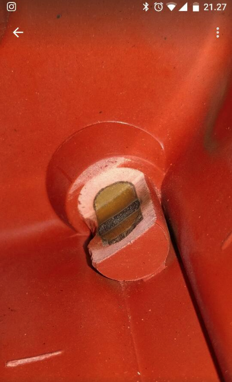

Took a look under the dizzy cap, are the contacts supposed to be lookin like this?
Edited by Kameeli, Sat Oct 22, 2016 7:44 pm.
