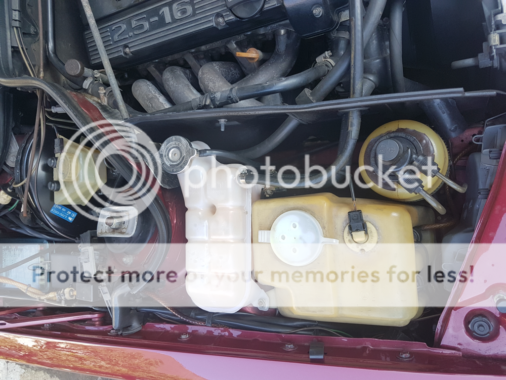

Hi All,
Could you help with parts number of all yellowish plastic bottles on the picture below? I think they are washer reservoir, SLS oil and brake oil container? I plan to refresh the engine bay a bit. My car is a 1991 190e 2.5-16v RHD. Many thanks all!

Well its up to you but not easy jobs to do .The brake fluid retainer tank will need the brakes bleeding after the job .And the window washer bottle [dark one ] will be easy to do . But the SLS i know nothing about this .It may need bleeding after removal .

Hello Olie, part numbers are:
Washer Bottle
(middle one) A2018691020 with that you will ned the proper
screw A2018690028 and
lid A2028609369
if you wanna replace the water level sensor A1265401117
And the SLS fluid reservoir part number is A2013200014
:) Ben

Btw for the washer bottle, part numbers are the same for cars with and without headlamp spray/wiper? Mine has wiper...just checking. I notice that some have smaller cap/fastener.

Different for washer on the headlights, as the normal bottle has only one hole for the motor, your looks the same as my 2.3-16 so that PN should be correct :)
